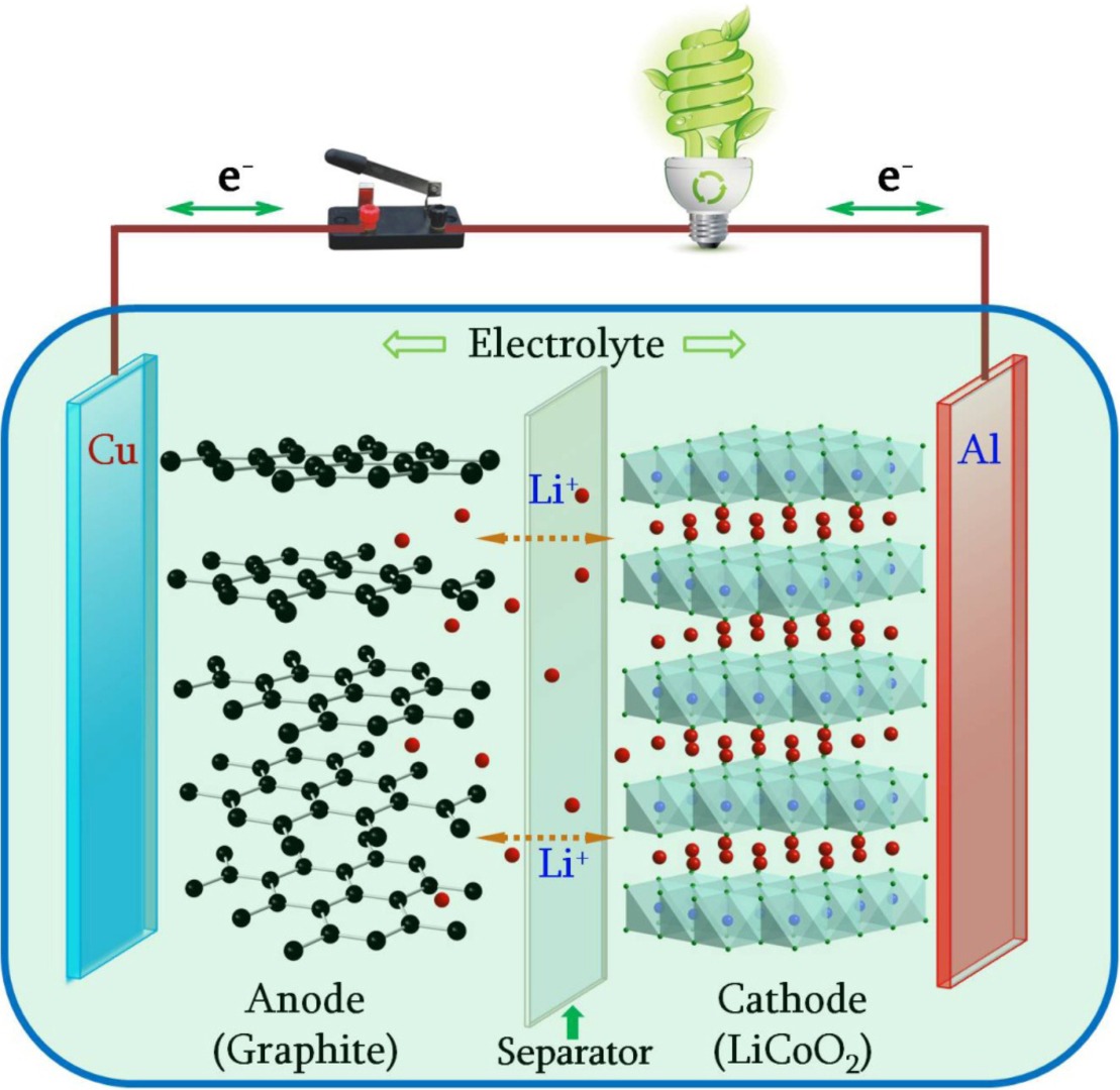

All battery packs generate heat when being charged or discharged. The lithium ion cell consists of two composite electrode structures; the cathode and the anode, separated by a porous polyethylene. Lithium ions are intercalated, or ‘sponged’ into the anode structure when the battery is charged (Fig. 1). Concurrently, Li+ ions are evicted from the cathode’s crystal structure. The anode and cathode are separated by a porous polyethylene membrane which prevents them from touching, but allows Li+ ions dissolved in organic electrolyte to move. During discharge, the current is reversed and the Li+ ions move back into the cathode. Cathodes are usually made from a combination of lithium metal oxides bound to the aluminium foil with carbon and other polymers. Most Li-ion battery cells use a graphite-based anode on a copper collector. Graphite is electrically conductive, so it can easily conduct the flow of electrons through to the copper collector.
The charging of a Li-ion cell is analogous to a multi-story carpark, where Li+ ions are cars. From empty, the carpark fills rapidly as all cars find a parking spot with ease. However as the carpark fills, it gets harder and harder to find a vacant spot, so the flow of ions decreases (resistance increases). Forcing more cars to enter the parking lot will only cause damage and generate heat.

The Li+ ion rich electrolyte serves as the internal conductor in the circuit. The mobility of these ions determines part of the cell’s own direct current internal resistance, or DCIR. The aluminium and copper collectors themselves are crucial too – the thicker the foil, the more current it can carry. Finally, the particle size and thickness of the anode and cathode matrix also drives the impedance of the cell – conductive materials like graphite and graphene is used to conduct electrons and lower the DCIR.
Figure 1. Basic representation of a Li-ion electrochemical cell. From: Understanding electrochemical potentials of cathode materials in rechargeable batteries, Materials Today, 19(2):109-123

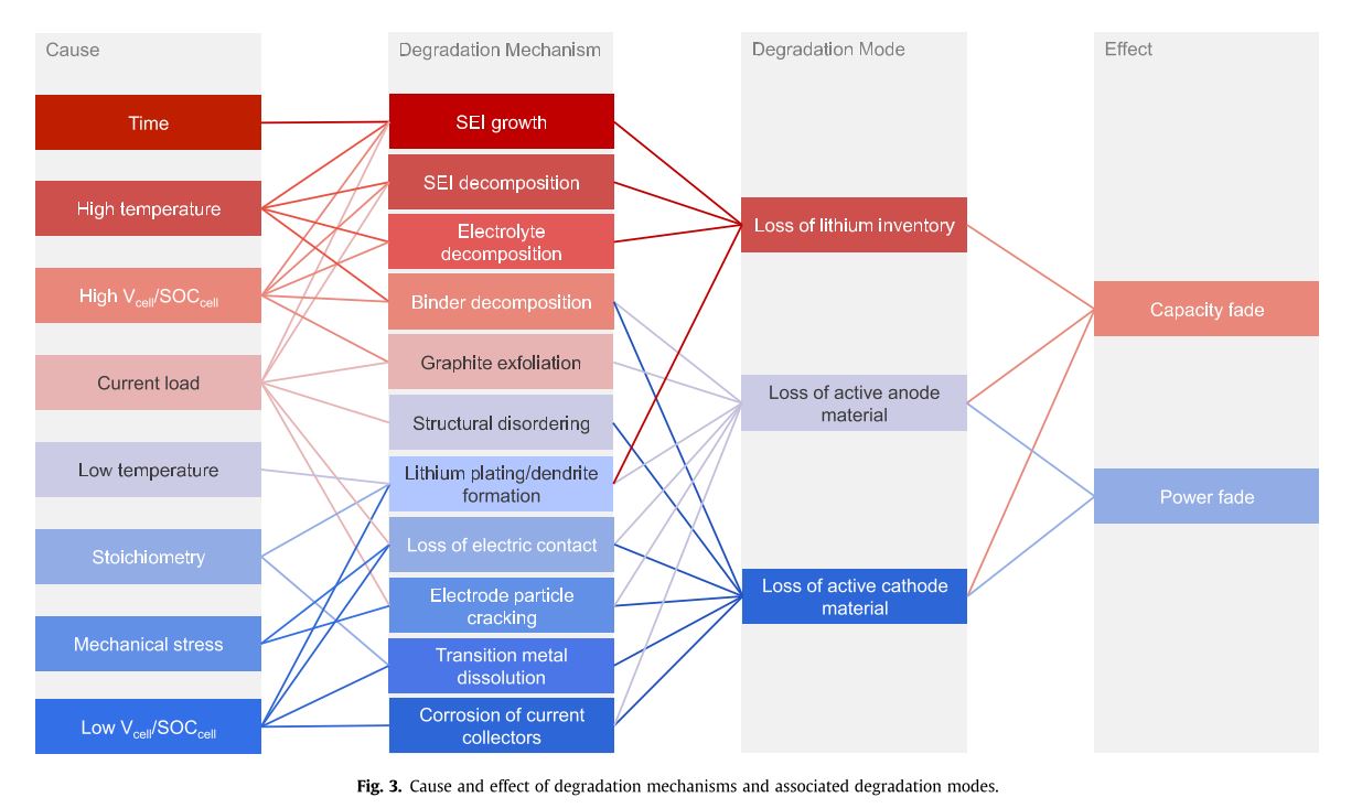

Li-ion battery packs work better when they are warm. Most EV drivers will know their range may increase by as much as 10 % during summer. This is because the internal resistance of the cell is reduced due to improved ionic mobility. Low ionic mobility is the main reason you shouldn’t charge a lithium battery quickly in low temperatures; the ions tend to accumulate and plate onto the anode, decreasing the inventory of lithium and ultimately decreasing the capacity of the pack. So batteries have a “goldilocks” zone around 25°C. However, good chemistry isn’t the only thing that takes place faster at higher temperatures – bad chemistry, the kind which blocks up the spaces for ions, degrades electrolytes and accelerates the breakdown of active material, all happen faster at higher temperatures too (Fig 2). In fact if the temperature gets high enough, the cathode material itself can start to decompose, leading to thermal runaway. This is why thermal management is critical – the cells must not get too hot or too cold, under normal operation.
Figure 2. A long list of all the things that ruin your battery. Temperature gets plenty of mentions. From: Degradation diagnostics for lithium ion cells, Journal of Power Sources 341 (2017) 373-386.

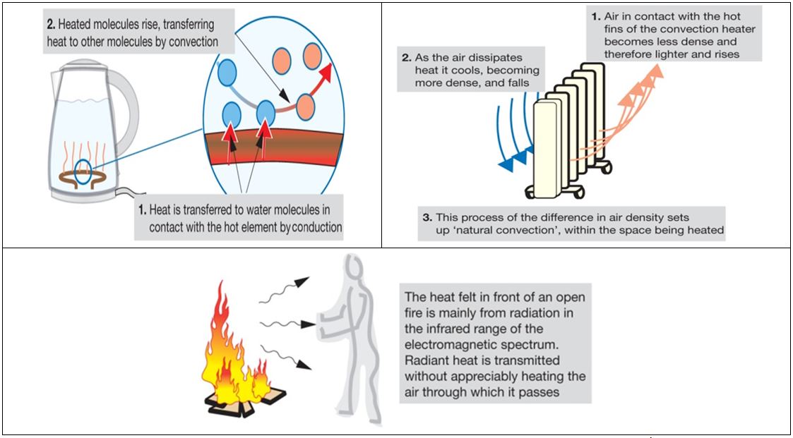

In all cases the process is the same – a large difference in temperature drives heat transfer (Fig. 3). Better conductors will allow more heat to be moved with lower temperature differences, and this heat may be dumped into a medium which has a high specific heat capacity away from the source. So with this in mind, how would one cool a hot battery without compromising its integrity?
![](/files/542/)
Figure 3. Conduction, convection and radiation. Source: Pethebridge &Neeson - Electrical Wiring Practice, 7th ed.

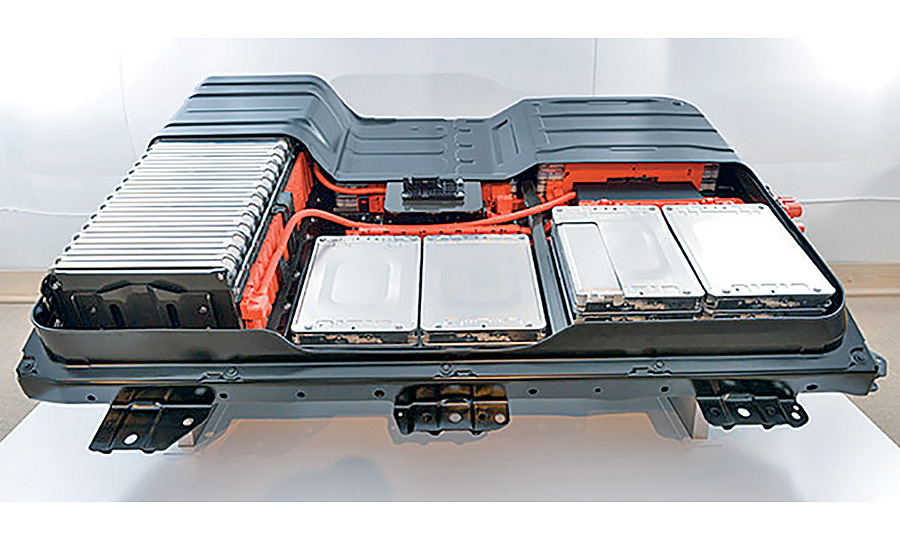

In its simplest form, a sealed battery pack will lose heat to its surroundings through convection alone. There may be many layers of structure between the cells of the battery and the outside air, all of which slow the transfer of heat. In cooler climates this approach is entirely reasonable, as it would take a significant duty cycle to generate enough heat to exceed 35°C. However in a hot climate, the difference in temperature between inside and out might be so small, or indeed negative, that the battery actually gains heat from the surroundings.
Figure 6. The Nissan Leaf battery has no internal cooling system – it simply loses heat to the surroundings by convection. Image: Nissan.
A passively cooled battery pack has several advantages over the alternatives – they are substantially cheaper, they cannot leak and they are fast to assemble. It does rely on the battery chemistry being robust enough to handle temperature extremes, and Nissan has gone to some lengths to ensure the cells are able to tolerate warmer conditions (Fig. 6). The obvious disadvantage is the risk of overheating the battery, particularly in heavy duty cycles such as repeated fast-charging on a summer road trip. The battery management system may enforce charge and discharge limits, reducing power to minimise temperature rise.

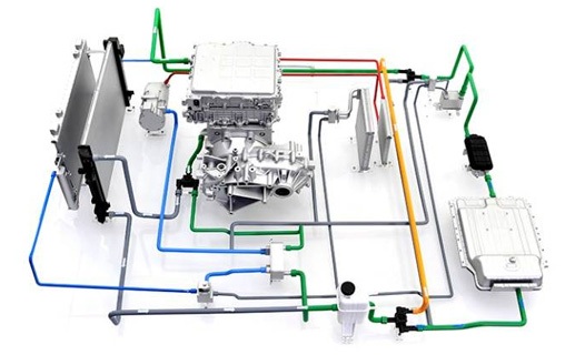

Electric vehicles with complicated cooling loops, bypass valves, A/C expansion valves and motor heat recycling systems are a fine example of innovation in heat management, but they also add complexity to the vehicle, providing plenty of opportunities for things to go wrong.
