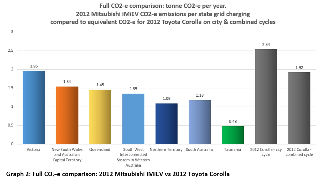

It is a relatively well known fact that the sticker figures for petrol and diesel vehicle emissions do not reflect their full ‘well to wheel’ emissions, making it hard to do a proper comparison between the emissions from driving an electric vehicle (EV) with an internal combustion engine (ICE) vehicle. In 2012 I worked to address this by doing a full carbon accounting based analysis to make an ‘apples for apples’ comparison between the then only available new EV (the Mitsubishi iMiEV) to a similar use new petrol powered ICE vehicle (a Toyota Corolla).
The conclusions then were – an iMiEV charged exclusively from the state grid emitted moderately to significantly less CO2-e in all states of Australia on city cycle, and only in Victoria was it slightly worse on the combined cycle as compared to the Corolla.

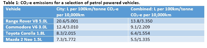

Calculation 1: Internal combustion engine CO2-e emissions.
Data: green vehicle guide (http://www.greenvehicleguide.gov.au)
Vehicle: Current model Toyota corolla; 1.8L petrol, auto, city cycle, 8.3L/100km
Assumptions:
Vehicle travels: 10,000km per year
City cycle chosen as most comparable to EV use.
Calculations:
Toyota Corolla: At 8.3L/100km, this gives a total of 830L used in a year (= 0.83kL).
Using the national Greenhouse Accounts (NGA) Factors (July 2017), emissions, in CO2-e are:
Direct emissions = burning of the fuel: 1913.2kg of CO2-e (table 4, 2017 NGA factors)
Indirect emissions = extraction, transport etc. of fuel: 102.19kg (table 40, 2017 NGA factors)
Grand total (in tonne CO2-e): 2.0154 tonnes of CO2-e per annum to run your 2017 Corolla.
For completeness, I have included the calculations for 4 vehicles in both the combined and city cycles, as given on the Green Vehicle Guide website. (Note: I have selected the auto option for all 4 cars, as automatics are the most common transmission choice in Australia).

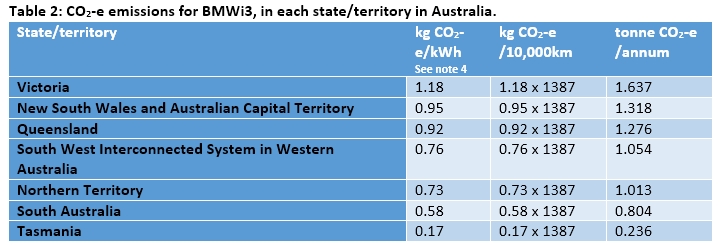

Current model BMW i3; 129Wh/km (see note 3). Mass market vehicle chosen in order to make ‘like for like’ test cycle comparisons with ICE vehicles. For owners of other EVs or retrofit EVs, try swapping your own figures into the calculations below.
Assumptions:
10,000km per year
EV battery charger efficiency: 93%
Calculations:
{129 x 10,000 x (100/93)}/1000 = 1387kWh per annum
Conclusions from scenario 1: buy an EV and do no other CO2-e reduction measures.

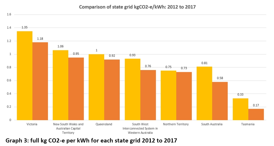

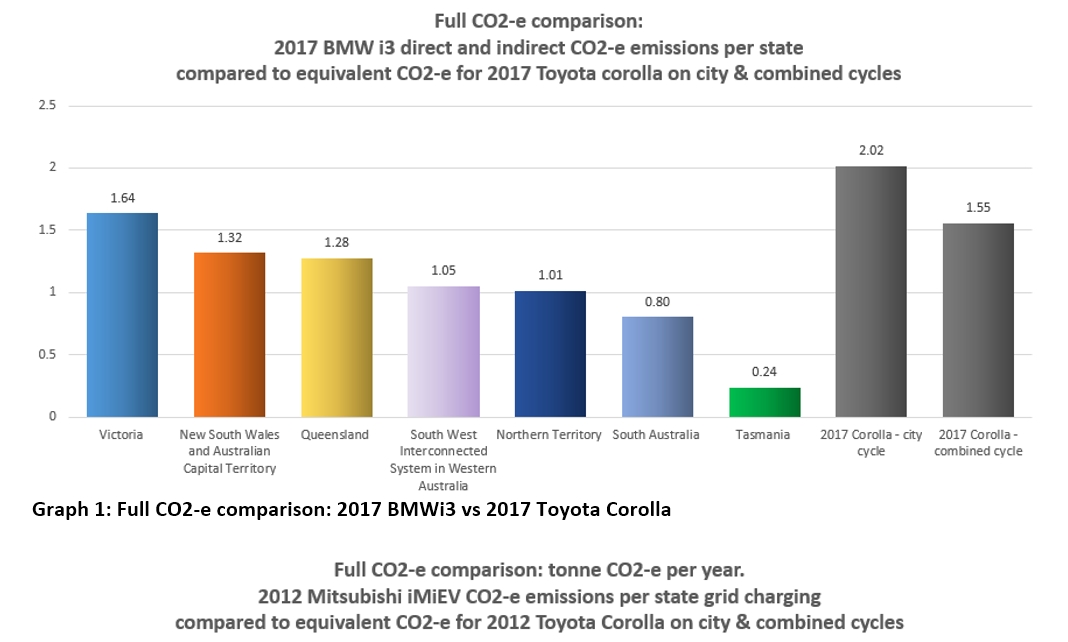

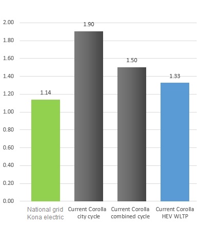

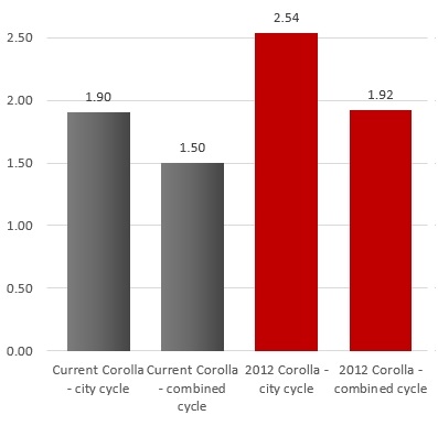

Interestingly, since this analysis was first produced in 2012 (see graph 2) – ICE vehicles have noticeably improved their consumption figures according to the test cycles. However EVs have also improved, as well as the general emissions figures for grid power improving dramatically in some cases. The result again is if you are swapping from ICE to EV for city driving – you have reduced you CO2-e for private travel in all states, and the gap in Victoria is increasing! Again, in Victoria (only) is the Corolla slightly better on the combined cycle – but the gap is also decreasing.
In summary: in 2017, choosing a new BMWi3 over a new Corolla 1.8L auto to use for city driving reduces CO2-e by just over 18% in Victoria, and by 88% in Tasmania. (All other states fall in between). For the combined ICE test cycle, EVs still come out well ahead in all states except Victoria, where it will go up slightly (5.3%). Mind-you this assumes you do no other carbon abatement measures for your electricity use. This option is explored next.

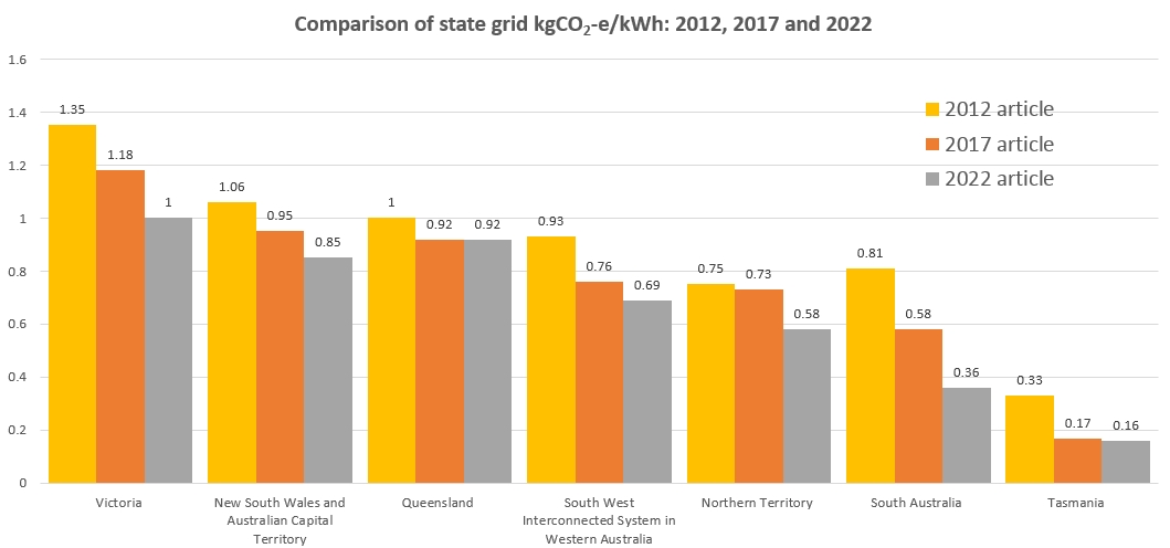

Going forward: as the grid de-carbonises year on year (as it has been doing – see graph 3) EV CO2-e will continue to decrease faster than ICE CO2-e emissions. Plus, with a tailored combination of grid connect solar PV, green power and/or a battery back-up system, these emissions can be reduced significantly further.
