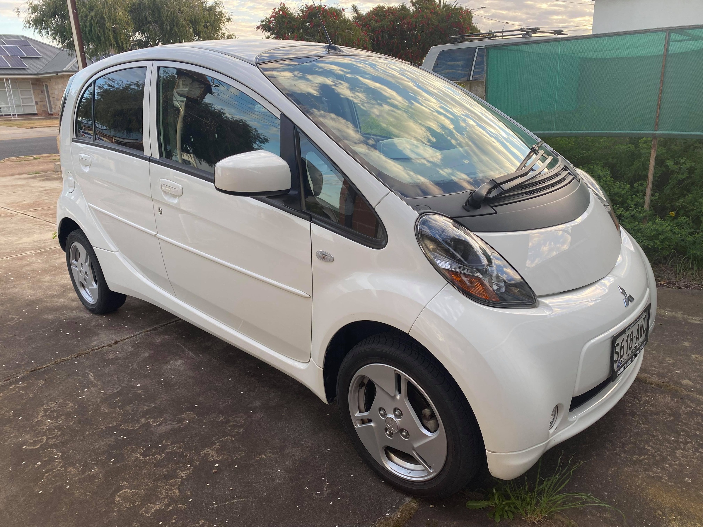

I've been experimenting with different wheels for the i-MiEV, and have found that quite a few OEM wheels (with some modification) will fit the i-MiEV.
The stock i-MiEV wheels are 15"x4" with an offset (or ET) of +35 at the front with 145/65R15 tyres on the front, and are 15"x5" with an offset of +35 at the rear with 175/55R15 tyres.
i-MiEV with OEM wheels

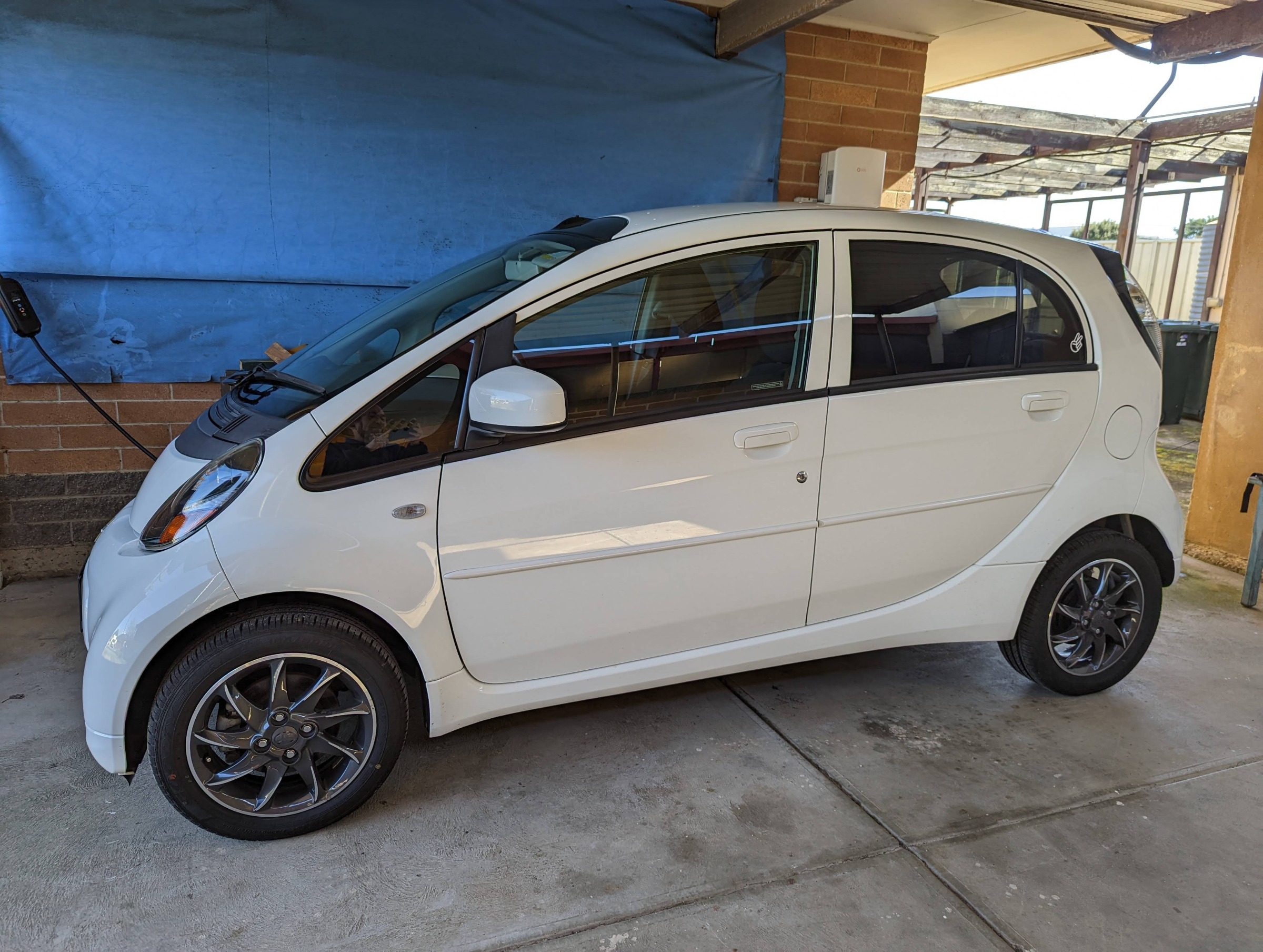

i-MiEV with Yaris wheels

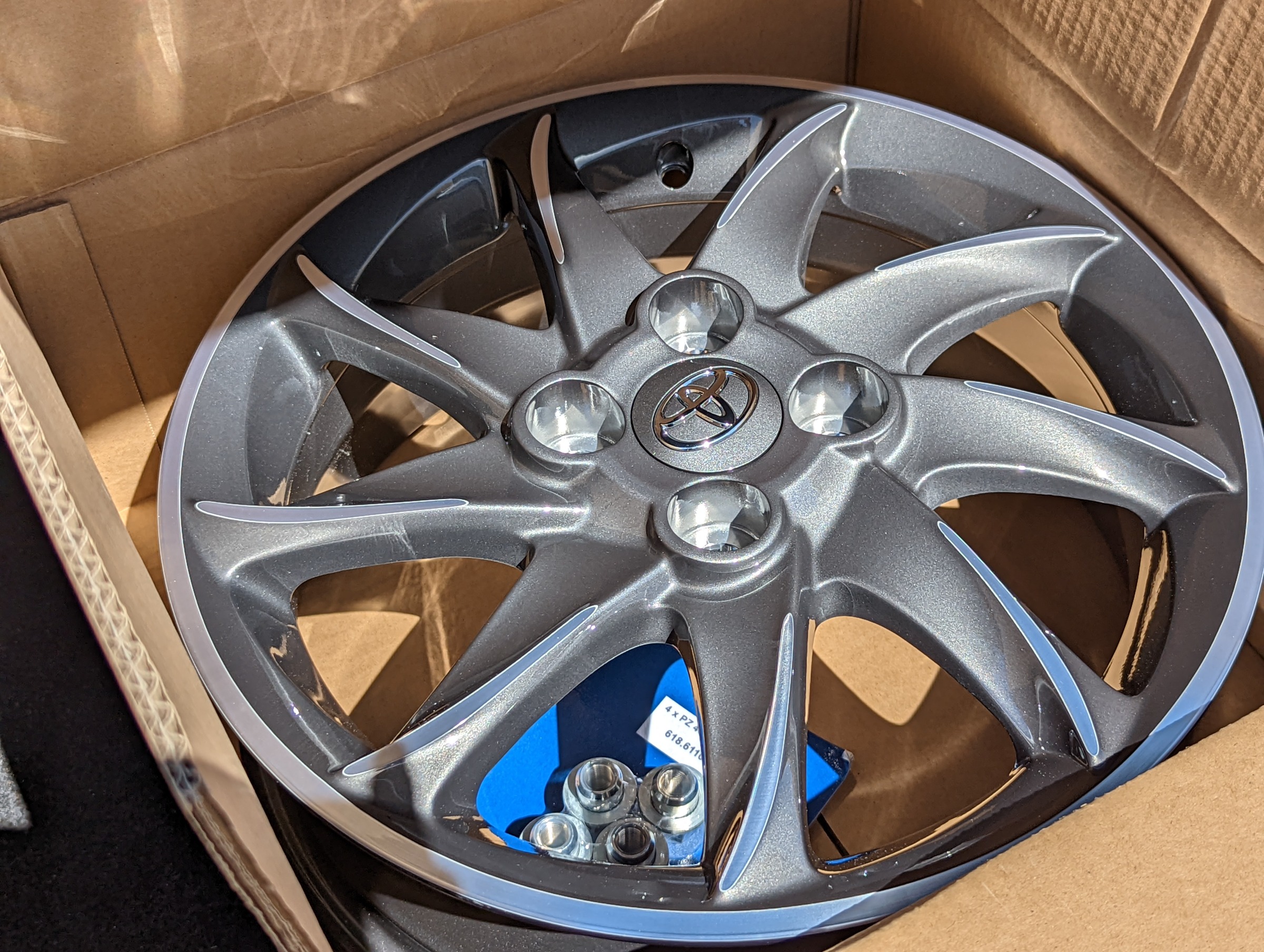

After some research of common OEM wheel sizes, PCDs, centre bores, offsets, scub radi, etc., I settled on a solution. My i-MiEV now sits on 2012-2014 Toyota Yaris XP130 5Jx15 ET39 alloy wheels (part number PZ406B067BZS) with 165/60R15 on the front and 185/55R15 on the rear. The new wheels are 17mm closer on the inside and extend out 9mm more on the outside, still fitting under the guard with plenty of room both front and back of the wheels and there is no rubbing or scrubbing. The tyre sizes I've chosen are both around 2% larger than stock, as they're both a more common size. It's important to make sure the tyre sizes are scaled scale evenly front to back, otherwise it can effect the traction control. I got my wheels with included wheel nuts for around $136 each, plus freight, new from a Toyota dealer via their eBay store...
Yaris OEM wheel, new in box
